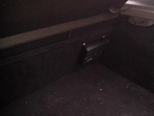

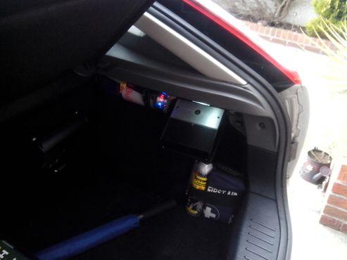

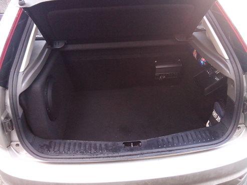

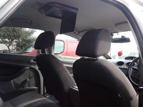

I've fitted two amplifiers; twin dash cam, tv tuner with pause & record, 10" roof monitor and a 1.0 fared capacitor,
Some items need there own supply from the battery with a fuse or rather a trip switch within the first 12" inches,

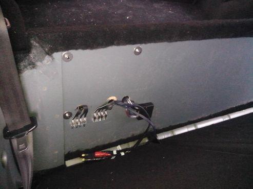

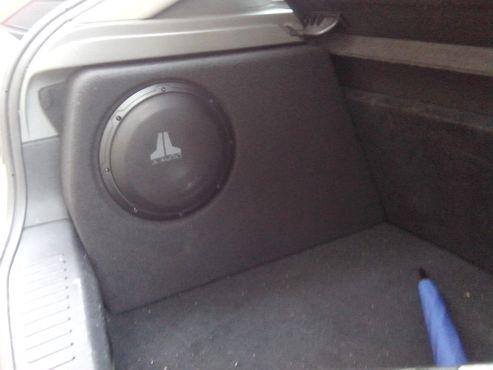

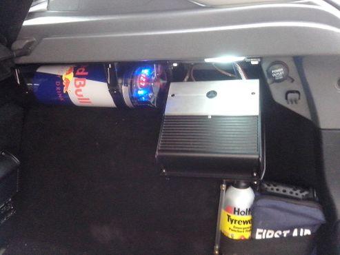

I've got two individual 4AWG feeds routed from battery to the boot for two separate amplifiers; one amp is on a custom built removable panel which unplugs for when the seats need folding down you then revert back to the headunits built in amplifier.

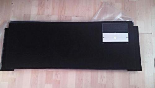

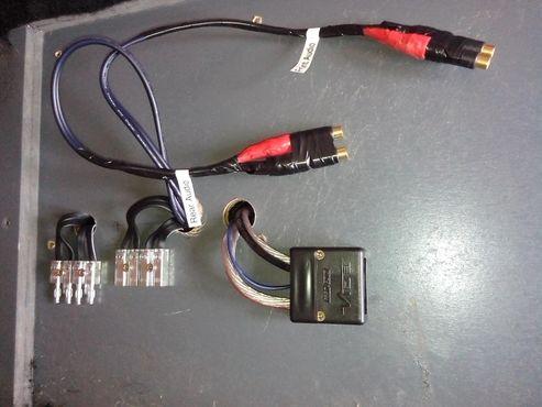

All connections are on sockets inside the rear of the panel just unplug from amp and plug speakers in to a supply from the radio
No drilling or fixtures required; I designed it to sandwich tight between the seats with a 25mm cavity space inside for cables.
IMG_20150131_152354_zpsaokbxsok_edit_1422723876733_zpsbczhfvp5.thumb.jpg.dbaed15d3fd282a5568e90dd78dec2d6.jpg
The red arrow below shows a socket containing four cables which are from the headunit front speaker output, unplug the feeds going to the front speakers from the amp panel and plug in to the output from the headunit to continue listening while the panel is removed for folding down of the seats.
