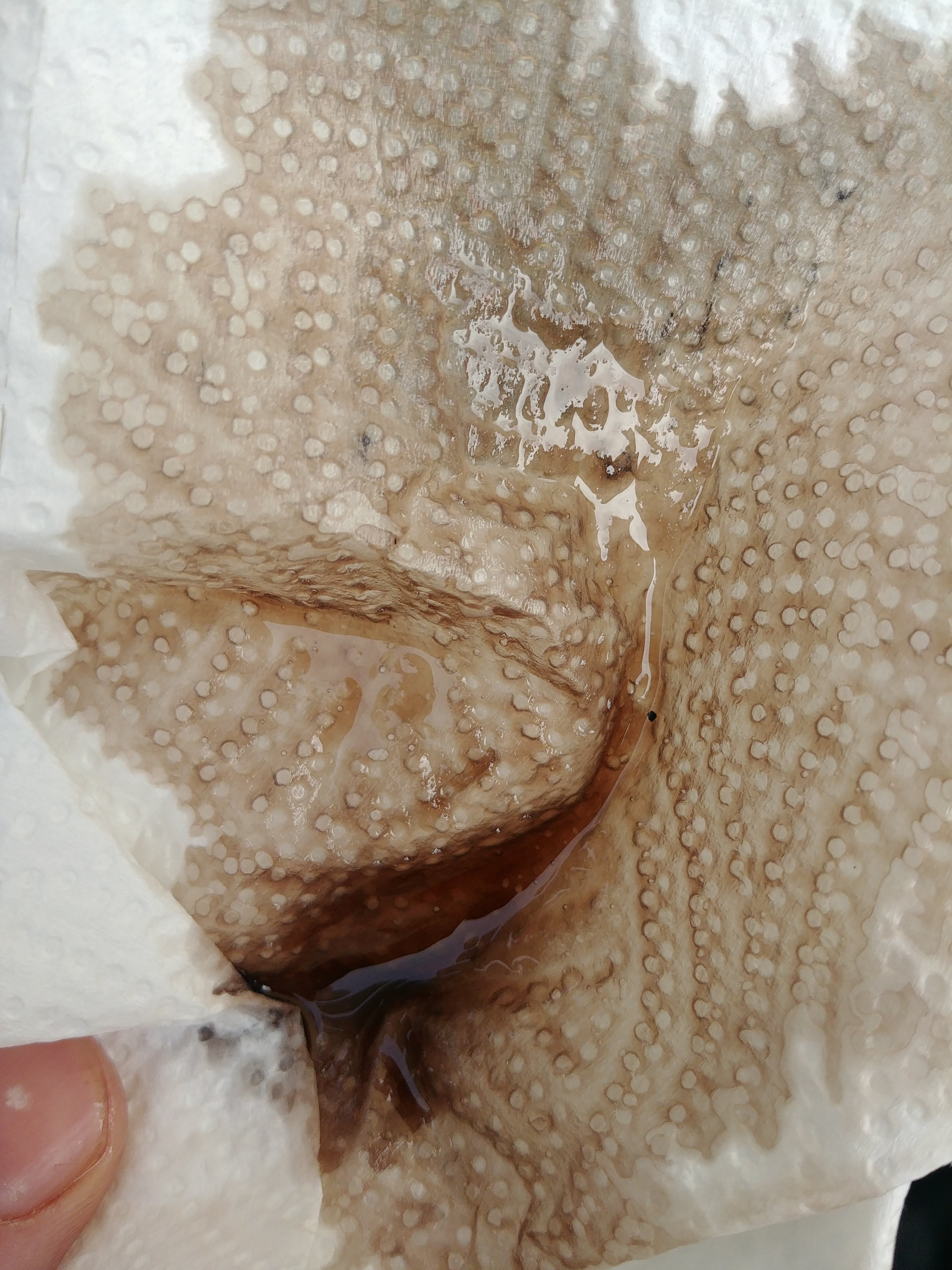

Here's a pic, for what it's worth. It's brown, which probably looks closer to red naturally, so I'm not sure if that means anything.  Maybe those in the business would know?
that looks red to me .. if it was green then it would have turned black .. i have a 2007 with mechanical pas.. i've always used red .. as it had red  in the reservoir when i first bought it new
Thanks ferretfloozy.
It looks very dark in the bottle, and unfortunately shows zero sign of red or green!
6 hours ago, TomsFocus said:
If it's a small petrol with mechanical PAS then it was almost certainly red.  The green was meant to be used with EHPAS although I have seen red in those as well.
This question gets asked repeatedly but I never have seen any concrete proof of which cars had which colour and when the exact changeover was!
that's wrong
ALL Mk2s should use green just like the handbook says
it was some lazy factories using up stock of old rubbish.... the red overheats and deteriorates, increasing wear in the pump and rack
it comes from a change in the rules on recycling where the manu remains responsible for clearing up the mess at end of life, hence they went to small reservoirs and the accountants took off the PAS cooler.  Hence Red could no longer cope and green fluid took over
you can run either but red goes black and wears things out whilst green stays fresh as a daisy
this pic from above shows Red fluid plus all metal from the damaged pump as its been running red rubbish
