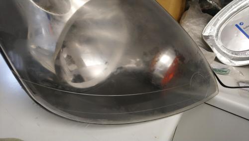

@TomsFocus and others need some guidance. Used 1000 grit on the headlights. Would this be enough to move to 2000 or 3000

@zain611 Give it a wipe over with a damp cloth and see if there's still any deep scratches in it.  If not then move onto the fine grit stuff.  I'd probably skip the 2000 and move straight to the 3.

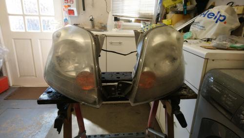

Should I sand the bottom half more? This is damp

I really can't tell from the picture, you should be able to see or feel if there are any of the old marks left now.  As long as it's only sanding marks left then move on to the 3000 grit.
It feels all smooth 👍. Also mostly removed that mark and that is smooth thankfully however I don't think I can remove all of it. Just feeling any rough areas and doing them before moving to the next stage.
@TomsFocus do I use the 3000 until the headlights look a little better compared to the way they looked with the 1000? So not as cloudy. Left had 3000 grit

Yeah that's right, the idea of the 3000 grit is to remove the scratches left by the 1000 grit.  :smile:
Give it a wipe with a damp cloth again and it should be fairly clear now.  Then the polish is like a really fine sandpaper that takes out the final scratches from the 3000 grit.

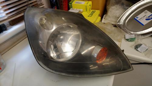

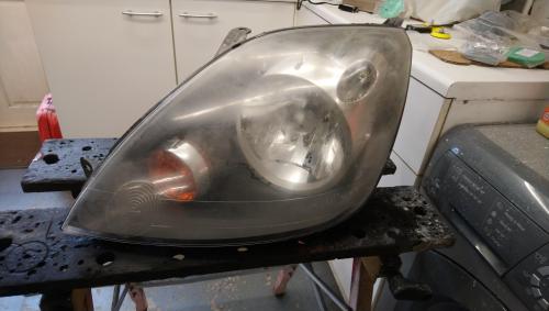

Left the headlights for today. Going to see if it needs further sanding then may move to either compound or polish. Want to do this just in case to see if the headlights will turn out good rather than just spraying the clear coat on. Hope I haven't sanded too much.
@TomsFocus what's your thoughts on how it looks? Sorry its my first time doing this so need a little guidance.

The top one definitely looks ready for compound for the final light surface cut.  Bottom one still looks a bit cloudy on top but that might just be the light and picture angle.
The right headlight my dad was looking at it and it looks like it's in a worse state so have to see. He ran water on both and they turned clear so a sign which they are ready. My dad did a set of headlights and he sprayed clear coat on them after sanding and they did look good. My machine polisher is with my uncle so have to see about getting it soon if I want to polish it.
I might sand the headlights by hand diagnoly as I heard the clear coat will stick better and probably skip polishing and just go with the clear coat. Can't drive the car without headlights and my uncle said he'll drop it off tomorrow at my grans.
