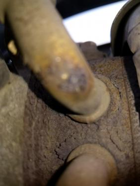

2013 1.0l Ecoboost engine rust. Problem?
If the pipes go you wouldn't be guessing what it was that caused the problem but that said i havent heard of anyone suffering a failure due to the rust on the pipes.
Paint the little suckers and hopefully none of us will need to worry.

  • I'm living in Denmark and can elaborate a bit on this.   It IS an issue, if it corrodes through, the turbo will die due to no cooling. You definitely want to get it fixed, however it's proba

It seems there is a lot of confusion here. The brittle pipe is the plastic one that has nothing to do with the "rust" problem that the turbo pipes have....or some have.
The metal pipes that rust really is a simple fix, if yours are rusting just bite the bullet and fix it or dig in for a tear up with Ford, whatever way you go, do it, could save a lot of pain. Mine were pretty good but for 10 mins work and a bit of wedge the problem should be fixed for now.

Not sure if there have been any failures yet, but there will be as it’s a vital connection. It doesn’t appear to affect all 1.0T though, so it’s likely it was a bad batch of connectors.

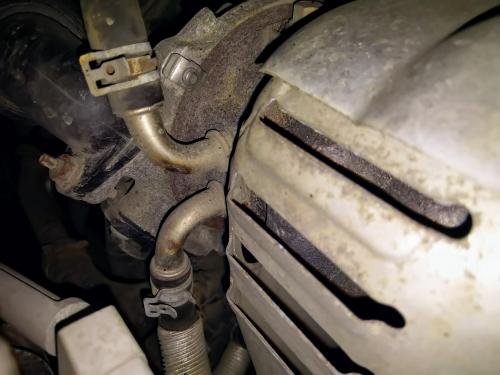

Had similar issues with 2013 CMax EB. Ford dealer just quoted £350 for new turbo pipes, corrosion in these pipes is causing a coolant leak.

Interesting. I understood that the pipes were not replaceable seperately?
Edited by Eric Bloodaxe
yes, that's what I understood. they seem to be pressed into the turbo in such a way that the pipes can not be changed in the existing turbo unit. The turbo and pipes coming as one unit from the factory
Just glanced at the Pumaspeed website where they offer stock or uprated turbos. The illustrations show the turbo complete with pipes pressed in.

Correct, the pipes alone are not replaceable. At the end of the day you can relax in the knowledge that if your pipes let go then at least the new engine will come with a turbo attached

Could have been mine - I posted a shot earlier in the thread when I got it in March 2018. The pipes are still unmarked but the cast iron turbo itself has now got surface rust, as you might expect.

Turbo body is cast iron, so it is normal for it to rust. The problem is the pipe that connects to it will rust (when not protected) once the turbo body has fully rusted.
