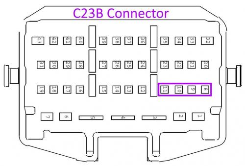

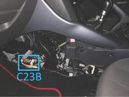

Next, we need to splice in to four wires that come from the C23B connector in the front passenger foot well:
Looking at this connector from the top down, these are the wires we need to tap in to:
You need to splice in to these four wires, around 5-10 cm from the connector itself to give you some room. Cut the 4 wires (8, 9, 10 and 11) and re-join them back together, one by one, along with a new wire that you will need to route up to where the 54-pin APIM connector will go. So basically you'll have the existing wire in one end of the crimp connector, and two wires (the existing wire and a new one). Do the same for all 4. If you don't have any wire, grab an ethernet cable or similar and strip it to reveal the wires inside, just make sure it's long enough to reach up to the screen area. Once the four wires are up near the 54-pin APIM connector, join to the corresponding wires as per the APIM wiring table.
