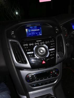

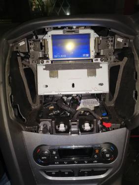

  • 2012 Focus Titanium Navigator
  • 5" Screen with Sony Head Unit (9 speaker) and Sat Nav
  • DAB, Bluetooth and Voice Control (non-SYNC)
  • Reverse camera
  • USB and Line-In sockets in the centre armrest / stowaway
All OEM stuff. Looks like my car build just missed out on SYNC 1.

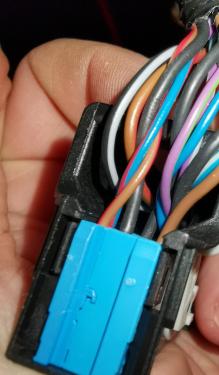

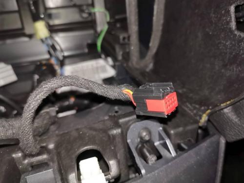

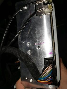

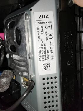

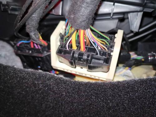

Pictures attached.
IMG_20191119_172658.thumb.jpg.7b289cb49c8cee211f8106bd7cab97de.jpg     IMG_20191119_173255.thumb.jpg.f5bcc35fb6dcbe4d314d70b4af762010.jpg
IMG_20191119_173805.thumb.jpg.72668655d0c3a1c7f9922b0d14b9ab4a.jpg     IMG_20191119_173521.thumb.jpg.18ae68664df333fcad5c365d5036c236.jpg
 IMG_20191119_173623.thumb.jpg.892120180c7b0ac3f6f5d649c923c05e.jpg      IMG_20191119_173801.jpg
I am aware that I will need  to replace everything from my current setup, and am aware of the cost of the SYNC 3 components etc, so I just need some pointers...
Can anyone help me with the parts I need to upgrade from non-SYNC to SYNC 3?
The main questions I have are:
  1. Looking online at the other threads it appears there is a 54-pin SYNC connector but my car doesn't seem to have anything with that many wires in, just the one you see in IMG_20191119_173614.jpg which is around 24 wires. What is this other connector required for the SYNC 3 unit?
  2. Will my DAB, sat nav, reverse camera and steering controls still work? Do I need specific part numbers when purchasing?
  3. My current screen has the blue (gps), pink (camera?), grey(?) and yellow(?) fakra connectors - do I still use these for SYNC 3?

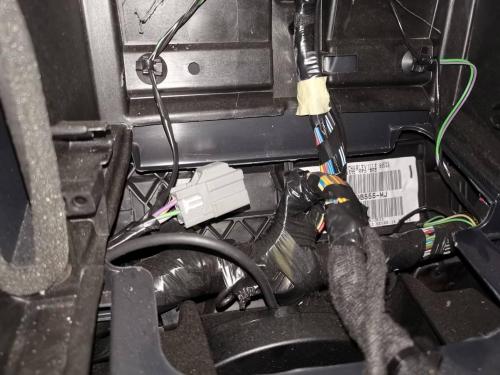

  4. Any idea what the taped up grey connector (in IMG_20191119_173606.jpg) is?
  5. The black/red connector in IMG_20191119_173623.jpg connects to the Sony front audio control panel (incl hazard and lock buttons) - is that still the same
Most of the existing SYNC 1 to 2/3 threads have wiring diagrams and other bits but since I don't have SYNC 1 to start with, it's tricky to get a starting point on what I need to do.
I am familiar with FORScan and software programming too so I'm comfortable messing with that as required.
I'll be forever in debt for your help in assisting with this project!
Thanks,
James

Is it possible I have it present behind my existing AC unit where SYNC 1 units used to be? As mentioned my car just missed out on SYNC it appears but you never know.

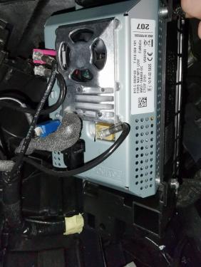

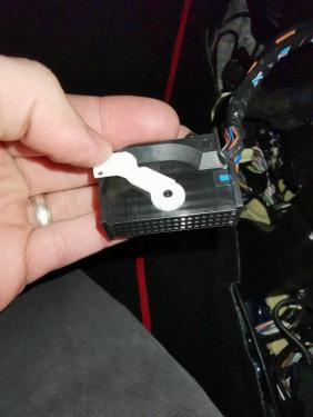

Behind your a/c controls is your bt/vc module, this is where you find the 54pin plug however I believe although visually similar the plug is actually a different shape to the sync one.
Looking at the 3rd picture i can see the top of the Bluetooth module you have to remove the heater control to get to that and that should have the 54 connector going to it and if it is different i'm sure you can fit the cover from a sync connector to make it fit

The unit I've been offered has these part numbers. Are these suitable for sat nav, dab and rear camera etc? I heard there is a 32GB and an EU 64GB version...
JM5T-14G370-HNC or JM5T-14G370-GNC (whats the difference?)
GM5T-18B955-SB
Sorry for all the posts today!
Can anyone also tell me what the two big connectors on the SYNC 3 head unit/radio are for? On my current BT/VC DAB radio, it only has one big connector as per picture 5 of the original post (looks like its the bigger one on the right of the two). Is it for the media hub?
Cheers

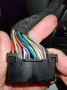

I had a look at the 54-pin APIM wiring that goes in to my BT/VC module today and it looks like this:

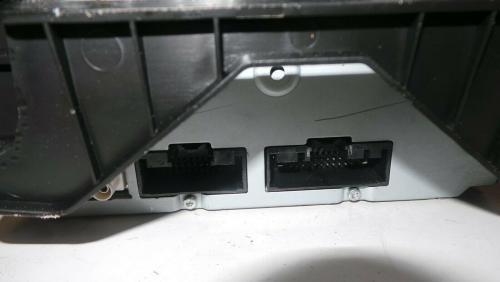

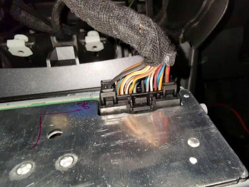

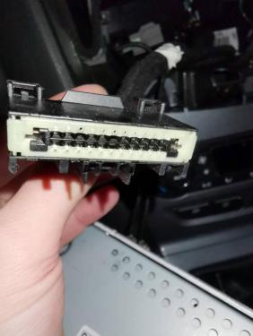

1) On the back my existing radio (ACM) I only have one 24 pin connector:
IMG_20191122_194332.thumb.jpg.550b34343398dea29893320193f1f7e8.jpg    IMG_20191122_194357.thumb.jpg.4eb3c66bd7f42c5c51e81655d426007c.jpg
But on the back of the SYNC 3 radio unit, i has two of these type connectors:
s-l1600.thumb.jpg.f620c30c6d7ce946e42f84e6e5ce9755.jpg.4f8fb8ebf0fadb93a12ee695fab6527f.jpg
 What is the other one for and do I need it?
2) My current 54-pin connector looks to have around 14 wires, whereas the SYNC 1 connector has 21 or so?
3) Are these the correct APIM model numbers for the EU (64GB) nav version? Does this have DAB built in? JM5T-14G370-HNC / JM5T-14G370-GNC

IMG_20191122_192251.thumb.jpg.417893afb0fef63d90c7bd4c61ee91e2.jpg  IMG_20191122_192736.thumb.jpg.385a0116487e048abfc2dad458e34495.jpg

I believe we have the same audio setup currently. If it's 2012 its likely to not be SYNC, just Bluetooth with voice control. On your steering wheel, do you have the green and red call buttons, with the volume up and down on the same bit?

Does anyone have the pinouts for the two ACM plugs that go in to the radio?
I believe the other one is for audio input from the SYNC module.

But then what is the other 24 pin connector? Doesn't that come from SYNC too, or is that the "output" to speakers etc?
Basically, I am trying to find a mapping between all the connectors I currently have and the new SYNC 3 APIM, FCIM and front fascia. Difficult to work out. Might start a new topic on that...

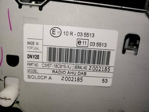

ACM: CM5T-18C815-XJ
FCIM: BM5T-18B955-DC (5" screen with NAV, DAB and reverse camera input)

ACM: CM5T-18C815-XJ

I'm pretty sure the 24 pin is speaker output, CAN lines, power, ground etc.
