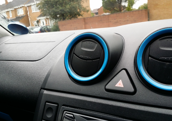

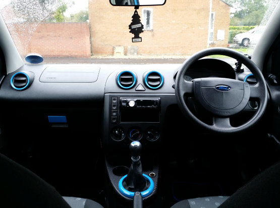

DMB Graphics post on Twitter a few weeks back saying there now manufacturing Gel Badge rings for the vents on the fiesta Mk6 and Mk7 in all colour and print styles see link: http://www.dmb.uk.com/prod/843/gel-badge-rings-for-heater-vent-surrounds-mk6-mk7

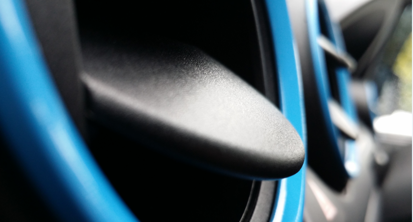

Do they do those coloured air vents for a mk6 not a mk6.5
The rings on the vents are the same size and shape on the mk6 + 6.5. They are interchangeable
But in the mk6 you have to take the dash out or get them out underneath
Not if you cut out the old ones and slide the new facelift ones in :)

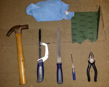

The tools you will need:
  • Hammer
  • A hacksaw that allows you to saw in small enclosed spaces as seen in picture
  • Curved File
  • Flathead screwdriver
  • Pliers
  • 240 grit paper
  • Cloth (microfiber recommended)
  • 4 New facelift vents

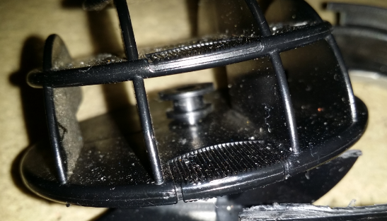

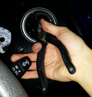

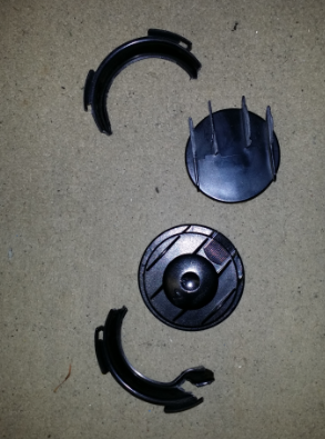

2. For each of the vents, you will need to do the following. In the centre of the vent ball, you will see a plastic circular object on each side that holds the ball in place. You will need to break this to free the ball from the vent surround. This can be done either 2 ways. Either saw at it or hammer your flat head screwdriver against it to break it off. A picture below is what the plastic circular objects will look like when they have separated, however yours will still be inside the vent.
BE CAREFUL NOT TO LET ANY SMALL PLASTIC PARTS FALL INTO THE VENT SYSTEM.

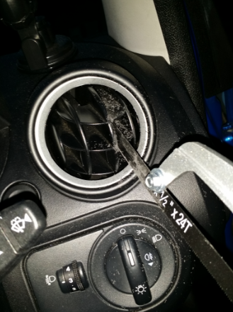

3. Once both sides have been parted the ball should be free within the vent. Now take your hacksaw and saw the right side of the centre plastic mould as shown below. If you did not part the ball with the use of a screwdriver earlier you are now able to saw the ball off with the hacksaw.
4. Now the ball should be in 2 parts within the vent. Using pliers, pull out the
smaller side of the ball.
Followed by pulling out the larger part of the ball. Do not be afraid of breaking any parts of the silver ring as this will be what comes out next.

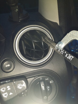

5. Now saw the silver bezel at any point and use the split to pull it out with the pliers. This requires a bit of force, using twists and turns. If it breaks at a point, not to worry, just start trying to pull from that point it broke at. YOU ONLY WANT TO PULL THE SILVER BEZEL OUT, NOTHING FURTHER DOWN THE VENT. Sorry I didn't get any pictures but what you're left with should be similar to this.
You are able to lift the silver bezel out by slipping the flathead screwdriver between the silver bezel and the black plastic surround. This will help you get a grip with the pliers. Though be careful not to use it for too much leverage otherwise you'll mess it up like my first one :(

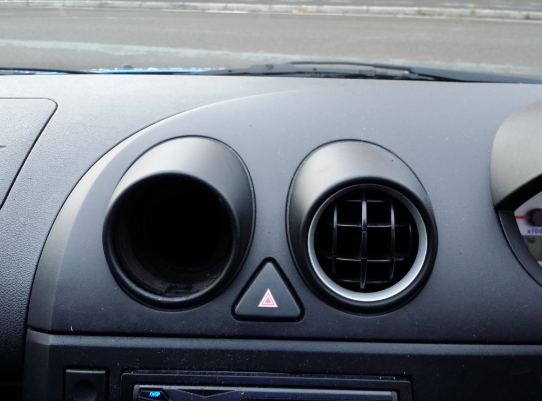

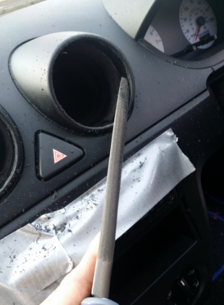

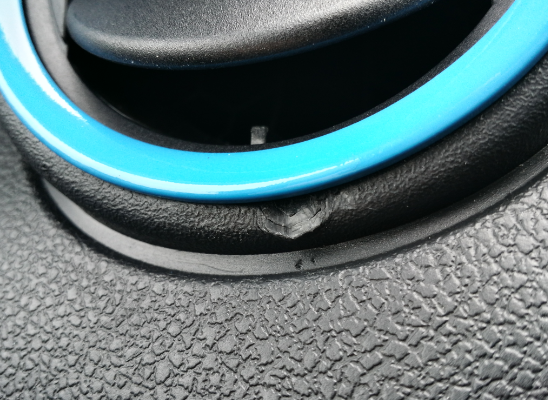

6. Now that you have removed the vents you should be left with an empty hole as shown below on the left. Take your curved file and start cutting away at the inside of the ring evenly. Use a facelift vent for guidance, and keep cutting until you are only unable to fit the last cm of the facelift vent into the hole. Use the 240 grit sandpaper to smooth out the edges and remove any last plastic cut-offs.
7. By now, your car should be covered in plastic remains. Use a vacuum or similar with the suggested attachment to remove these plastic cut-offs. The attachment shown allows you to get to small crevices that plastic may have made its own way into.

8. Now fit your vents until you have the last cm that you cant push in without great force. Use your towel to cover the vent and your hammer to gently push the rest of the vent in. If youre convinced it will not go further, file a bit more, sand smooth and clean again.
